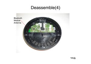

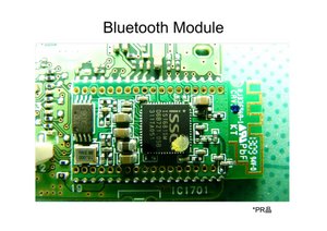

@tommythoma67144 just found some disassembly instructions. Panasonic is full of it.
Just so you have them Panasonic SC NT10 Dissasmble
So we can debunk the nonsense they spread, while you work on your speaker, take lots of pictures. Once you are done with it, take those pictures and create a guide for iFixit. That will help the next person that has a device with the same issues as you do. It's easy and fun to create these guides. https://ifixit.com/Guide/new The iFixit community will appreciate this.

@oldturkey03 There are three screws on the bottom under the rubber stoppers. There also looks to be two torx screws on top. I didn't want to try it until I knew someone had done it and done it successfully.
@tommythoma67144 the only thing that might be glued could be the three legged concealer of the screws :-) A good hairdryer should take care of that :-)
