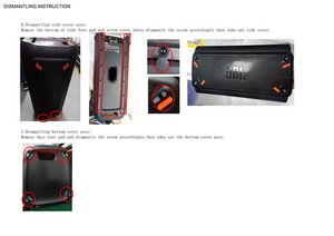

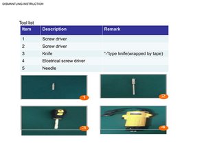

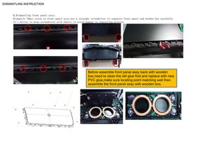

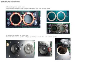

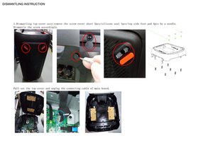

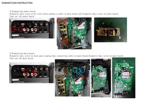

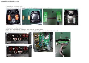

@tina3793 so it doesn't show you any sign of life. It is dead, not just not charging. Make sure that you first check your power supply. Should be a 12V 8A adapter. Then check the power jack. Make sure it is not bend, corroded or has debris inside of it. Next you will have to check the power board. For that you want to dismantle your PartyBox
Once disassembled post lots of pictures of your boards etc so we can check them with you.
