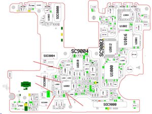

I'm a clumsy boy, and often drop my phone when I don't intend to. Recently I have been experiencing an issue where I have zero bars and no service whatsoever, not even emergency calls. Done all the shabang, checked sim card in other phones, new sim, factory reset etc, so I'm guessing it's a hardware issue. Is there any way this can be fixed, perferably cheaply, and is it possible for a well educated technician to do it and retain some level of water tight seal?
@swanny21445 "is it possible for a well educated technician to do it", Yes. "retain some level of water tight seal" Maybe.
The very first area that you want to check, are your antenna cables. Those connect to the sub_board (daughterboard) Make sure they are all seated right and that there is no crack on that board. I Personally would even consider replacing it. Then check the flex cables from the daughterboard to the Main board. Check for tears and cracks in the connector etc. After that you are looking at a board issue.

Thanks, this is really useful. My CP says "A528XXXXXXXX" does that mean it's likely just a loose connector that can be easily reseated inside? If so I mighty even have a crack at it myself. How do people handle atleast splash resistance when repairing devices like this, does Ifixit sell adhesive that will be able to provide at least some protection if I get caught in the rain.
@swanny21445 yes it could. Check those first. If they are seated right, continue down the flowchart
