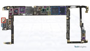

The microphone at the bottom of my Pixel 6 Pro phone is not working with any app (phone, keyboard/gboard, recordings, etc.). If I record a video, the top microphone is picking up sound, which I confirmed by covering the pin hole with my finger and sound stops recording. I have verified the bottom ports of the phone are clean, and tried gently cleaning and blowing out any debris (swab was clear) with no effect on recording sound. It seems the microphone needs to be replaced but I am unable to find a repair part for the microphone.

Okay, first off, I'm afraid Google has done us dirty by having the microphone and the USB-C port soldered directly on the motherboard. I'm sure this saves them a few pennies on each unit they manufacture, but when it comes time for repairs, it's a purely evil decision.
A bit of research was required, but I located the microphone itself on the motherboard. Here's a picture with it highlighted, courtesy of the teardown done by the TechInsights website.
As you've already surmised, replacement parts for the motherboard itself are few and far between. You could consider scavenging one off of a junk motherboard, although you'll have to find one first. The other thought I had was that the Pixel 6 non-pro model does have a replaceable top microphone which is available for sale. I don't know for sure that it's compatible, but I strongly suspect it would be. Here's an example of an AliExpress seller who has the part for sale.

If you're good at soldering and have a hot air station, this may not be too bad of a repair, but otherwise you may have to find a repair shop who can unsolder the parts from the Pixel 6 flex cable and the 6 Pro motherboard then replace the defective one.

Many thanks for the detailed response! I had not considered the microphone component is soldered onto the mainboard. This cleanly explains why I have been unable to find this as a replacement part on any site.
The top microphone does not seem to be an issue, so unfortunately the top microphone part won't be of any use for me.
I think I will take the phone apart and see if there is something simple that can be fixed, otherwise it looks like I need to find another mainboard to swap in or have an authorized repair shop order the board and put it in.

@stevbev Actually, on our 6 Pro phones the top microphone is also soldered onto the motherboard; it's on the opposite side though. The separate top microphone from the 6 non-pro I was suggesting as a purchase was solely for the purpose of unsoldering it from the little flex cable it comes with and using it as the replacement part for the lower microphone.
But yeah, if you open it up you'll be able to directly access the microphone and clean it out with isopropyl alcohol (90% or higher concentration only!) and/or canned air.
