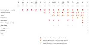

What that means for you is that swapping out the motherboard means that a large number of functions on the phone will simply stop working. Face ID will be disabled, True Tone will no longer function, you won't be able to see your battery health, your selfie camera can't take pictures, wireless charging won't work and your taptic engine may or may not still vibrate. Here's a chart listing all of the parts pairing Apple has done to the various models of its phone.
So basically you would have to buy a replacement motherboard and all of its paired parts if you want everything to work. Unfortunately, that means you now need most of the interior components of the phone, so there's no point in swapping a motherboard when you need everything else as well. Apple has made sure that swapping a motherboard is no longer a viable solution for getting around an iCloud lock.
