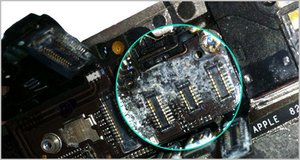

@altname usually corrosion is a white or orange usually powdery or waterspot like. ill attach images if it helps ^^

You’ll need to clean the area with 90% IPA as the water stain is the Minerals which is in the Water and corrosion it caused.
