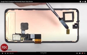

First of all, I had to do some digging to figure out just exactly where the proximity sensor is on your phone. I found a teardown video that shows the guy pointing to exactly where it peeks through the display. Here's a screenshot from the video here.
Google Pixel 8 Teardown Disassembly Repair Video Review - YouTube

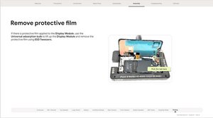

The pry tool is pointing to the viewport for the proximity sensor. Here's what the replacement screen looks like out of the box.

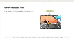

So yeah, it looks to me that the large black sticker is covering the proximity sensor viewport, rendering it unusable. Unfortunately it looks like you're going to have to open it back up again to take that stupid sticker off. Here's the part of their guide showing when you assemble the display to the phone.
