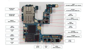

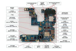

@yathinsabapathy motherboards are available but these are used. You will never really know what you are getting unless you purchase from a reputable seller. Do not go by ebay, Amazon or AliExpress rep points. Most of those are really not properly achieved. This is one of those situation where you want to buy from a reputable seller and with a credit card where you can get your money back, in case somebody wants to cheat you with damaged or locked boards. Buyers beware.
Oh yes, make sure that you get the right board for your exact model. There are a few different versions for it: SM-G988B (International); SM-G988U (USA), SM-G988W (Canada); SM-G9880 (China, Hong Kong); SM-G988N (Korea)
No, the Samsung Galaxy S20 5G board is not compatible with the Ultra model
Galaxy S20 5G SM-G981
Galaxy S20 Ultra 5G G988
