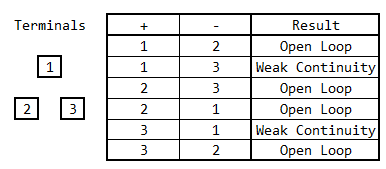

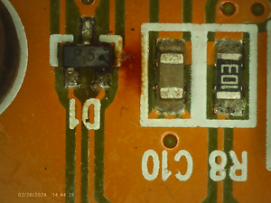

I am in a similar situation - interface won't connect to PC and upon inspection there is discolouration at this same D1. I have attached photos I have taken for your reference.
Although I suspect this diode is defective I did some continuity tests captured here in this image:
I too am trying to identify and replace this diode so if you have any luck please let me know too!
Looks like a dual TVS to me, for USB signal.
