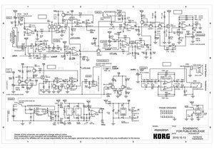

don`t power on how to fix it
my monotron do not power on testing it with a 3volt AcDc Adapter Could you help ,please-
or have i to throw it away?

@dreye throwing stuff out is not an option. Let's investigate.You mentioned testing it with a 3V AC DC adapter. Is that what you have checked? What else have you looked at. Use this guide KORG Monotron Teardown to tear it down. Then take a couple of good pictures and post those with your Question. Lets see if we can identify any issues. Your Monotron will work with 3 V but it uses a boost circuit that brings the voltage to 5V. I would start with the boost circuit and check IC1 TPS61071

@dreye we will have to check if the boost circuit works.
Hi @dreye
Here's the schematic that will help to find the problem.
hi Jayeff,
thanks for schematitic-link,.but i had have downloading the same Dokument yesterday morning .
but i still first have learn how to solved my problem,really don`t know what is the best Methode to
found the bug .. ,i have a multimeter only have to find out how to use that in this case
@dreye
Connect the adapter to the device and then use the meter to see if there's 5V DC at the VCC test point as shown on the schematic or pin 5 of IC1 or on R3, C3 or C1.
If no good, check that there's 3V on pin 6 or pin 1of IC1.
If OK on pin 6 but not on pin 1 disconnect the adapter and use an Ohmmeter to check if L1 is OK and has continuity.
If no voltage at all, check that the earth multiple on the board connects back to the -ve terminal of the battery holder or adapter plug.
If the earth multiple is OK then check that the +ve terminal of the battery holder or the adapter plug connects to L1 and pin 6 of IC1
If there is 3V on pins 6 and I of IC1 and there is an Earth connection on pin 3 of IC1 but NO 5V on pin 5 of IC1 then IC1 is faulty.
Note: be careful and don't short out the pins on IC1 by bridging the meter test probe between 2 pins on the IC. Make sure that the probe touches 1 of the pins only when testing!
