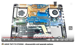

Disconnecting Wifi and Bluetooth Automacically , even after reset the respected drivers , reinstallation of respected drivers , i tried everything by the help of youtube , but nothing helps .
" Disconnecting Wifi and Bluetooth Automacically occurs only whenever device is moved slightely " nothing happens when the device is remains in a same position !!!
this problem occurs only when the device is moved slightely or lifted or disturbed in its position !!!

Do you mean that the WiFi and BT are just disconnecting or that they're intermittently not working anymore?
If just disconnecting try using the WiFi (or BT) as close as possible to your network router (or BT device) i.e <10cm and check if the connection remains stable.
If it does it may be a faulty antenna connection on the WLAN/BT card that is the problem.
If it still drops out or if it still fails etc it could be a loose or faulty WLAN/BT card.
Here's an image taken from this teardown video showing the location of the WLAN/BT card with the attached antennas.
(click on image)
