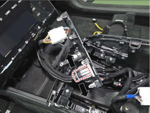

Bought a used 2022 Hyundai Tucson Hybrid Blue but the data USB port is damaged like in the picture below and the dealership won't do anything about it, OEM parts online are only about $30 wondering if there is a way to safely remove the trim to get access to the internals to swap it out

  1. Disconnect the negative (-) battery terminal.
  2. Using a flat-head screwdriver, remove the floor console tray assembly (A).
  1. Remove the USB (A) by pushing hooks in the direction of the arrow as illustration below.

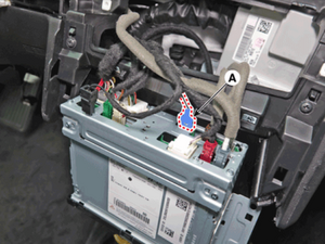

  1. Remove the audio unit.
  2. Remove the USB after disconnect the USB connector (A).
do you mind sharing where did you get the instructions online please.
Chilton's manuals. You may be able to access it through your local library.
@wicked62123 I’m having the same issue. Were you able to fix it yourself?
@cvneutron - can you provide the website to where you found the instructions?
Same here. Was anyone able to fix it ?
