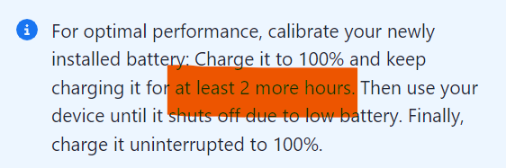

I got an S10e replacement battery around December. Once installed I calibrated it by draining the battery, charging it to 100% and draining it again. It has been a few months now and the battery life is still just as bad as my previous battery (lasting around 6 hours on 81% battery health). Why is this happening?

did you leave it on the charger for 2+ hours after it got to 100%?

I did leave it charging for more than 2 hours once it reached 100% when calibrating the new battery. I do have accubattery installed and it says that the battery health is at 81%, 2419mAh out of the design capacity of 3000mAh. My previous battery health was around 60 to 70 percent.
