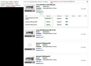

My model battery (taken from Lenovo Vantage) is 5B10W13914. I see three part numbers on the Ifixit store when I search for my p/n, but I can't confirm compatibility. Which one is the right one for the Lenovo T590? How do I figure this out?

Ifixit shows an 02DL011 battery in the Lenovo ThinkPad T590 Parts list, which is an equivalent, compatible battery.
Here's an image from the Lenovo T590 manufacturer's support pages, showing the part numbers for the batteries that are compatible with your laptop.
(click on image)
The batteries that ifixit show when searching for 5B10W13914 in their parts list are mostly compatible batteries? as they have a different part (FRU) number on the battery itself.
As can be seen by this ifixit link (PC Laptop Parts - search for 5B10W13914 in the search box) most of the batteries have different capacities (mAH rating) and when viewing some of them (those that have a zoom option) the part number isn't one of the ones that is shown in the parts list in the image from the manufacturer, so I am not sure whether they would be compatible.
I suggest that when ordering, ensure that the part number is one of the ones shown in the image above and not just that the seller states that it is a compatible/equivalent, just to make sure.
