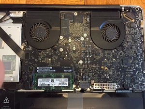

Ok, so after dealing with this exact issue for almost a month now (pink lines on white, green on black), with the only short fix being to press behind the left shift key, I have come up with a simple solution that may help a lot of people with this.
After taking off the under/back cover and keeping the computer on (as to see the pink lines) I touched different spots to confirm where to pressure needed to be to get rid of the issue. I also notice that if I plug my computer into my TV via HDMI, the screen issue doesn't transfer to my TV, so I knew it couldn't be some hardware issue, but instead had to be some connection issue to my computer screen. Why, then does the pressure "work" to solve it? Well, turns out that behind the motherboard there is some loose connection going on here, and pressing on that point completes the connection that is either loose, or has lost it effectiveness somehow.
So then, there are some ways to approach this:
1. send it to Apple
2. take off the motherboard, and fix the connection yourself
or...
3. just tape a few folded up pieces of electrical tape under that exact spot, and then put your cover back on so that the pressure is kept on this spot (completing the loose connection) thus solving the issue.
This seems to be the best way to fix this without spending money and time. My MacBook is a 2010 model, so I don't see the point in spending a lot of money on repair, or risk going under the motherboard and start soldering this since I am not an electronics pro. Just use something nonconductive like electrical tape so that you don't short circuit your board. Also, I've seen some people suggest taping something like a penny on the outside (under the computer) case but that wasn't as effective as putting tape inside, and seems to only work for an hour or so. It's less direct pressure and isn't as good at applying the needed pressure.

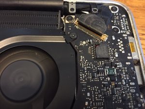

UPDATE:
I took a look at the connector of the dipslay data cable to the logic board, which looked perfect, reattached it and screwed it back together, no result. It's still the same. Any ideas anybody? I can't really cough up the dough to replace this laptop and it feels like it is really easy to fix if you know how to do it.

This pink line problem is remove by following procedure
1 . Remove left side cooling fan
2. Insert wooden pencil (first cut in approx 1 inch in size) in the gap between motherboard and keyboard black paper (purposes is to lift the board)
3 fix fan again
Note Please shut down the computer before removing fan
This is hit and trial method
I personally believe that you have a loose screen cable. In order to fix this, you must take the display off, and check if the cable has a loose connection between the display and the logic board. Once you re-connect the cable completely to the logic board and display, put it back together and see if that fixed it by booting your macbook back up.
If that didn't fix it, you can try playing around with the Colorsync settings to make it look a little better.

So, somewhere in this string of posts and answers I saw one that talked about a “piece of a pencil”. I have just tried it and it seems to be working—30 minutes and counting.
Note: my fan grills were choked with dust & laptop would get very warm/hot. Had purchased two fan base to help issue.
fix process:
Open the back
remove left fan
wedge 1/4” to 3/8” long piece of pencil between back of keypad and mother board. Make sure to miss solder points!
et voila!
If this fails at some point I’ll amend post. I still don’t know what the actual problem is!
UPDATE!!!!!! 5 NOVEMBER, 2020
PINK LINES ARE BACK! Still same thing—pressure on the case in certain places makes the thing go away. Obviously, the pressure is being put on the inner hardware—but where and what?
