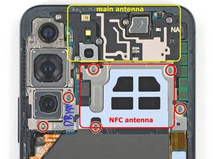

I recently replaced the battery and charging port on my Samsung S22. Both seem to work fine, however I no longer get any cellular signal. I've double checked that all of the connectors are properly seated and reset the network settings without any luck. Any ideas?

Turns out, the new charging board was damaged on arrival. I swapped the old one back in and the mobile data started working again. I guess I'll keep living with a finicky charger port until I can get a new part in.
(It's not a 5G phone btw)

@benjaminbashor double check your work. Remember that your main antenna on a plastic cover on the top. Make sure that everything has been put together again. You are not telling us if you have a 5G, those antennas are in a different place.
