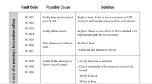

unit is not blowing showing error message FC=007
FC=007 MESSAGE on Model 775
@debbiehearellrn this error is possibly a bad sensor (Hose end sensor 2 open) but check the possible causes as listed in the service manual
You can get the service manual for this unit from the bottom of this page Arizant Bair Hugger Model 775 Repair - iFixit
