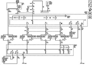

My left rear power window isn't working and my left rear door says door open when door is closed.
@alexhernan47451 two separate issues same door. Makes me wonder if this is a wiring issue. Before doing anything else. check the harness going into the door for any damage. See if there are any broken wires etc.
Update (02/19/24)
Here is the schematic for your Silverado. It'll give you an idea which wires to test. It could be your switch, so check that first.
I did check wires and they are clean no corrosion or wires disconnected. I'm really confused. Really can't afford to take dealership.
@alexhernan47451 I just checked the wiring diagram and those two things are not connected. DO you think you can get the door panel off so you can take a look at the switch, and the motor for the power window? I'll check for a relay etc and see if we can figure it out.
