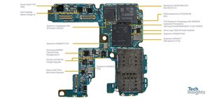

Ram/Nand Flash modules on motherboard.
Hello, I am a computer engineering student and I have been working on trying to figure out this information for a while now. What FBGA does the the S20 ultra 5g use. I have been trying to figure out if it is technically feasible/possible to upgrade a 128gb storage with 8gb ram or lesser phone to a 512gb/16gb with the right NAND and LPDDR5 modules.

@kennethtre22 looks like it is using a Samsung KLUEGBUHDB-C2D1 flash storage. Now we would just need to find something that uses the same ball array but has an increased storage capacity.
This is from a SM-G988N
It's a standard eMMC chip with UFS 3.0 interface, the problem is not the chip itself, rather how to install the firmware onto it. I'm not sure the phone will just accept any replacement chip, there could be some low level data transfer necessary.
