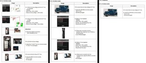

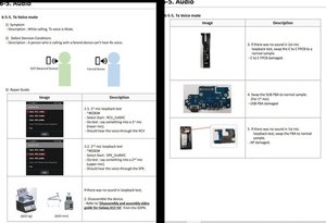

My microphone doesn't work anymore. I have done everything Samsung have proposed, I have even done a reinitialisation. What should I do?

Use a strong light and a magnifying glass to check if the voice inlet hole, located at the bottom edge of the phone is blocked. If you can't tell use a vacuum cleaner to try and clean it anyway, just in case. Do not try to clear it using a pin or probe etc as you may damage the components on the board.
Can you still be heard OK when using the phone in loudspeaker mode (hands free mode) on a call or using the Voice recorder app?
Here are some images taken from the service manual showing the troubleshooting steps for an audio transmission problem, that may help.
