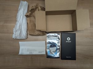

Replaced P7P with Ifixit kit, has white line on display
Replaced P7P screen with Ifixit kit, has white line on display. Attempted disconnecting and checking the ribbon cable multiple times, still with line. If I take a screenshot the white line isn't there.
Any tips?
Contact iFixit store personnel at support@ifixit.com. The parts they sell are genuine Google parts and come with a lifetime warranty.

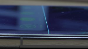

I have the same problem. I have had my screen replaced 3 times. The line starts as a green line, 1 pixel wide, and is usually intermittent until it widens and whitens. I had my phone serviced at ubreakifix and the tech's notes are "there is a white line on the right side of the screen starting at the top and running to the bottom / no phy or liq damage..... " "Condtion Notes: Very good. No visible physical damage. Little to almost no cosmetic wear. (No more than 3-5 small, minor cosmetic blemishes.)"
Today I called Asurion and said I was going to warranty my device because I feel like I have evidence that it isn't a screen issue and that a certified tech did not find damage (there isn't any) so I don't expect to have my deductible charged upon receipt of the device... and that if I am charged, I will challenge that charge and expect that a third party would agree with me."

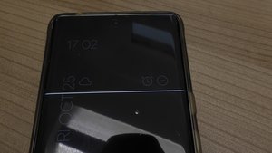

I've encountered a similar issue, though mine seems a bit different. After being satisfied with my repair for over two months, I was greeted this morning by a white horizontal bar on the screen.
First, I made sure it wasn't software-related by restarting the device and taking a screenshot. Unfortunately, the problem persisted.
Given the following, I assume it must be a faulty panel:
  1. I used an ESD table and grounded myself during the repair (yes, I am vocationally trained in electronics and have that stuff at home).
  2. I made sure no pins were bent or protruding during assembly.
  3. The display had been working perfectly for more than two months, and then suddenly, this issue appeared.
  4. There was no physical damage to the phone, and nothing unusual happened while it developed that bar (it was just lying on the desk and charging overnight)
I will contact support now and provide an update as soon as I have more information...

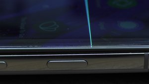

I had a vertical line running the entire length. I took pictures and was given a return postage. I got a new display and that one worked as it should. This was 8 months ago, and I am still an Ifixit fan. No issues other that time.
