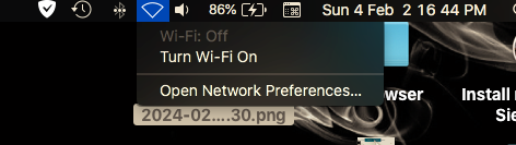

Update (02/06/24)
@danj Hi How u?? so new drama.. lol
So the "no Hardware disappeared, but now the wifi wont switch on.. tried deleting the config, resetting ... nothing its just stuck there.
@rahimpirbhai - Sorry somehow I missed this. This battery is not healthy! You need a new battery ASAP!
As for todays note on the AirPort bd Try disconnecting the board from the cable and likewise the cable from the logic board and reseating it. If that fails you'll likely need a new cable. Grit can damage the cable where it is compressed against hardware.
@danj Tried that and we back to square one lolzzz this laptop is just becoming a nuisance now... its frustrating
@danj you think it could be the battery causing all this headache?? im ordering another one
