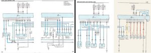

Why Central locking is not working
Central locking faulty
Hi @manuelanos
What is the year model of the vehicle?
It is a 2003/07 model
Hi @manuelanos
Not sure if you meant central locking using the ignition fob key or the door switches.
Are the hazard lights blinking when you unlock/lock the doors using the ignition fob key?
If not have you checked/changed the battery in the key to see if that worked?
Have you checked if the 20A Door fuse #31 in the instrument panel fuse block is OK?
If both the key and the fuse are OK here's the wiring diagrams for the power door lock circuits that may help.
(click on image)
Hi @jayeff, Greatly appreciate your time and effort to help me. I will use the information you supplied to troubleshoot this issue. Thankyou for the schematics too.
