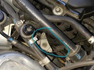

My Forester 2008, 2.0, non turbo, manual trans, has the same problem for months: when I first start driving the car, it starts off pretty well, but after about 15 minutes worth of driving my brakes start to feel tighter and it gets harder for my car to accelerate. I have tried to change the supposed culprit rear right brake bands, then to cut both edges in every band, but nothing works. Reading about it, seems the fail is on the ABS system. I have exact the same problem as you: after 15-20 minutes driving, the problem appears. I read someone extracted the ABS module, put it on a cardboard box and with a heat pistol, heated the module for a while. That trick solved the problem. I will do the same when I have the time and the heat pistol available (now I have only the box ;). I would like to know if someone could solve in other way that problem? Thank you!

There is an additional feature on the Subaru's called Hill Holder if the spring on it breaks it will never fully return and cause the brakes to drag. ( I think this sounds more likely then and ABS issue. ) If the ABS was the cause you would feel it and see a light on the dash.
Try checking the Hill Holder system its typically on the left hand side from the drivers seat in a right hand drive in the engine compartment. I googled a picture for you of what they look like on the Subaru.
