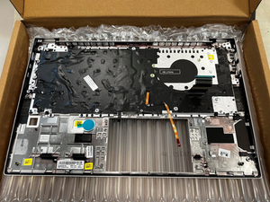

I need to replace my keyboard because I have to change the frame. Unfortunately, I’m not sure how to proceed. I watched several teardown videos but couldn't find any information on disassembling the keyboard. It appears to be riveted to the frame (see pictrure attached).
The new frame i bought also seems to have specific holdings for the rivets.
Could you please provide some guidance on how to remove the keyboard?
Hi @bluecorn
Are they metal rivets or plastic?
In any event most probably you will either have to drill out the rivets (if metal) or cut/melt them (if plastic) and then insert the keyboard into the new frame and then affix it as best you can at the rivet points using an epoxy adhesive.
