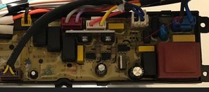

Giantex/Costway washing machine model EP24731US stopped working recently after a tree hit a power line apparently causing a power surge (neighbour's lights burnt out) and the machine to stop working.
The diagram of the program control board mentions a single 10A fuse but I am not sure how to identify it.

@areiadodeserto can you find the Blue connector on the control board? Then follow the black line to see if you can locate the fuse. If you have it open,, post some good pictures of the control board etc. Maybe we can find something. Adding images to an existing question
@oldturkey03 thanks! just updated the post with pictures
Hi @areiadodeserto
Follow the black wire as indicated in the image below to locate the fuse.
There may be a brown wire that connects to the black wire on the other side of the fuse i.e. black wire on one side, black and brown on the other.
Usually fuses have their ratings marked on them. The fuse is a 10A fuse most probably rated at 250V but the 10A rating is important
(click on image)

@areiadodeserto
Looking at the diagram you posted above the fuse is located somewhere between where the power cord (that plugs into the wall power outlet) is connected to in the machine to where the black and blue wires connect on the board as indicated by me
I'm wondering if the fuse may be located inside the box shown in the 2nd image you posted above if the power cord connects to it first
Unscrew the lid of the box and check.
Be safety aware make sure that the washer is disconnected from the wall power outlet first ;-)

Sadly the fuse was working
So am assuming the control board is dead...

If it is no longer within the warranty period I can't make it out to well on the image you posted but check the components to the left of the power connection (blue/black wires) to the board.
One looks like an MOV (blue component) but I can't make out what the black ones are even their board designation would help to identify the type of component.
Do initial testing using an Ohmmeter without the power connected to the machine.
As for replacement boards check what is printed on the sticker on the other end of the board and check what is states e.g. board model number perhaps?? and maybe search for that rather than the machine make and model number (it's obscured in the image under the cable with the 2 yellow wires)
