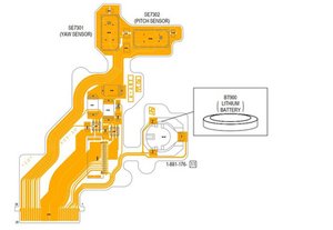

How do you change the internal battery?
@chimi5334 the battery is on the GY-024 flex board. It is a BT900
When replacing the BT900, be sure to replace it with a new GY-024 flexible cable, including the battery holder. According to Sony, the battery holder removed once cannot be used again.
Here are the instructions for the SONY SLT A55 Disassembly
Thank you for this information. Does this involve soldering?
@chimi5334 No it does not
