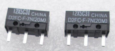

In this case, the only thing I can see is that click left button is broken.
  • If this item is still under warranty. It's best to make an insurance claim right away.
  • If you want to fix it yourself. Replace it with a new mouse switch. Require soldering skill (Make sure is the same item as your mouse)
crwdns2944067:09crwdne2944067:0:
where can i buy those parts?
mostly you can buy it from online shopping.
Pudieras adjuntar alguna pagina de donde encontrarlo ?
Oh, man, need another switch ((
On your pic don't Logitech MX Master 3S
The switch shown is wrong. The original part number is EVQ-P0D07K. This part is more clicky but may last longer: EVQ-P0E07K. Kailh Mute Button 6 * 6 * 7.3mm may work as well.
