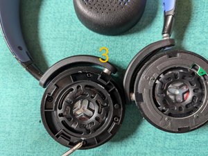

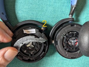

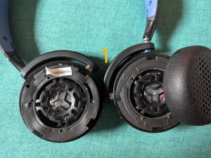

Have old green (the BEST colour!) AKG Y500 where battery has reached end of life. Any help how to open headphones and replace the battery would be super! I don't mind a bit of soldering, if needed. Also, if anyone knows where to get a new compatible battery, that would be appreciated. Thanks!
pry the Right ear pad off
peel off rubbery ring
find and remove 4 Philips screws

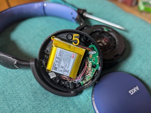

remove the outer plastic cap
the battery is soldered to the circuit board
