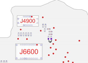

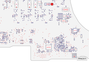

As I recall, this is where they stopped featuring proper power on pads. There is a test point on the back of the board, which you could use, but I wager the easiest place to accomplish this is to use a resistor and a capacitor near the Touch ID and Audio connectors. This is on the same line as the Power On Pads from previous generations. It references SMC_ONOFF_L. This means it turns the System Management Controller on or off when the voltage is low (shorted to ground).
Short these two components together
The relevant Test Point—short it to any nearby ground

I assume the 1st option requires removing the logic board to gain access to the “back of board”? (I wanna avoid disassembly)
So, is the 2nd option easier and viewable by just removing back cover?
So, just short it from that small circled red pad on bottom-right (from that 5x5 grid of pads) to a ground (upper mid right) with some sort of wire, correct?

@edgar27392 So I might have explained this in a weird order. The grid is indeed on the "bacK" of the back. The side that faces the keyboard when installed.
The One I would use is the one on the "front" side. So you don't have to take the board out. That would be the first image. There should be two itty bitty components right next to the audio and touch ID connectors.
I’ve found it! (tiny cap & resistor)
It’s under the hinge-cover & touch-id-cover (T3 screws).
Looks easy! Thanks for your knowledge.

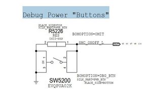

@edgar27392 this is just to determine if there is a different way. @flannelist take a look on here. According to that, the debug for the power button is on the top side (keyboard side) of the board
but if you look closer at the schematic, SW5200 is actually on the bottom side of the board (PLACE_SIDE=BOTTOM). Pin 1 is bottom left Pin 3 bottom right, 2 top left and 4 top right.
Applying a simple jumper, like a paper clip or a flat tip screwdriver, and bridging 1/2 and 3/4 should accomplish the same thing. Please correct me if I am wrong here. Wouldn't be the first time :-)

Nice work! I was looking at those too and wondering if they could do it.
I'll try bridging 1 > 2 and also 3 > 4 at the same time.
Edit:
Just tried it... no bueno.
Tried bridging/shorting 1>2 & 3>4 at same time with SS tweezers and surgical scissors.
Tried +10 times, also held for 10 secs. No response from computer at all.
(unless I bridged the wrong ones... but I def tried LowerLeft>UpperLeft and LR>UR)
