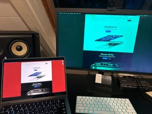

Hey ifixit community,
I have a question about a 24” LG Ultrafine 5K Monitor. The screen shows a picture, but it is equally greenish tinted, see attached photo.
I tried 2 different MacBooks and different cables. Also the screen has 2x usb-C input and it doesn’t make a difference which one I’m using.
I assume it’s a hardware defect on the mainboard, the question is if the defect allows to narrow down, where to search on the mainboard.
Do you have an idea what could possibly be the problem?
Thanks!

I tried different color profiles and settings, but not explicitly reducing the green value. Also, this would be just a work-around, I'm interested in fixing the hardware problem. It would be great to hear if somebody here knows, if this is common defect and usually caused by a resistor/capacitor or damaged chip - so if there is a reasonable chance to fix it without replacing the whole board.

@lukash72300 could be your Gamma IC or your video processor. Have you changed the input source? Something different then your MacBooks?

Hi Francisco, I had to give it to the official LG support here in the Netherlands, they fixed it for around EUR 320 and were faster than I expected. It came back in perfect condition, so I need to think it was money well spent in the end.
@gianfranco52715 Thank you – I've sent mine to an authorized repair and they quoted me a similar fee for a new motherboard. Reading on the internet, it seems that the thunderbolt connector is poorly mounted onto the board and is rather fragile. I can't confirm it's that that got damaged, but it's a shame, because everything else is impeccable, still working, and the image overall is great. It's good news that a new MB can save all the material from going to waste, but a shame that it seems the board design/work isn't up to the quality of the rest of the display.

Salve, vi dò io la risposta corretta e definitiva: SI DEVE OBBLIGATORIAMENTE SOSTITUIRE LA SCHEDA MADRE. È un chip andato, non dicono esattamente quale, am la devi sostituire tutta. Purtroppo ho speso 250€ circa. Non so se ne vale la pena, soprattutto per coloro che hanno comprato l'LG usato, ma non ci sono alternative. Purtroppo, e dico purtroppo, sul mio, ma a questo punto anche su molti altri apparecchi, avevo riscontrato la rottur senza spiegazioni della cornice esterna. Mi fu sostituito anche quella e dopo 1 anno è più rotta di quella di prima. Speravo di trovare un Teardown completo, ma non c'è nemmeno qui.
