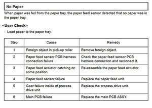

I have a Brother HL-3140CW. The tray is full of paper, but when i try to print from that tray, the printer panel shows "No Paper". It doesn't jam, it just doesn't feed. When I feed from the manual feed tray, the printer works fine. I have cleaned all the pick up rollers for that tray, but no luck. i have come accross this video with the same problem, but it is for a different printer model and the mechanism is different:

@franc30948 printers are just a totally different beast to fix. Just like anything else, use a systematic approach. So start with this flowchart
Now, to actually work on it and to narrow it down, You can download the SM from the bottom of this page Brother HL-3140CW
