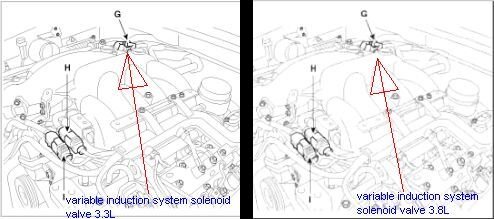

The solenoid connector is partially disconnected, and Im asking where the location of the connector is
Hi @hippienative
Here is an image showing the location of the VIS (variable induction system) solenoid valve connector for both the 2008 Sorrento 3.3L and 3.8L engines.
