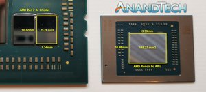

Also, this may not be the same exact CPU, but note that some capacitors are missing in this similar AMD SoC:
Yes, seeing some teardowns , the CPU has caps missing in the exact spots as me as seen in the updated pictures!

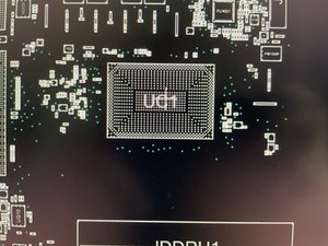

The best that I can find out is that the motherboard is an LCFC NM-D562.
I couldn't find a free download for the boardview, so you will have to purchase it. (This is the cheapest that I could find) You will also need to find the appropriate software to open the boardview file to view it as well
crwdns2944067:015crwdne2944067:0:
The board view in the picture is the one for the laptop, I managed to find schematics, but a technician told me Bypass caps won’t be listed in there

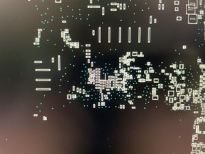

This is what happens when I flip the mobo in the boardview
