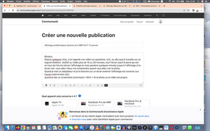

However, when I use an HDMI adapter and connect it to an external screen, the display is fine (on the external screen of course). When I take a screenshot (command + Shirt + 4) the photo or video is clean. On the two photos (one is taken with a smartphone and the other with the screenshot manipulation described above), the display is clean. It's really annoying and I'm starting to miss the good old Macbooks that were known for their robustness. 4 years ago the graphics card in my 2013 MBP burnt out even though I was hardly using it.

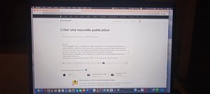

Having said that, I'm sending a message of dissatisfaction to APPLE's management to tell them that it's not right to rip people off and sell them products that cost the earth and jump so easily and for no reason. So, here's a screenshot of the macbook pro screen (with Command+Shift+4) at the moment when the screen starts to twerk.
And here's a photo taken with my smartphone at the same time.

As you can see a clean image external display, the internal display has the problem.
The internal display assembly needs replacing as its T-CON logic is damaged within it. This series had cooling issues around the T-CON board which sits within the main case area. You will want to make sure your systems fans and heatsink fin area are clean of dust and debris that often collects around them, also make sure the vent areas are not blocked and get a good thermal monitoring app like TG-Pro so you can monitor things as well as ramp up the fans when things get a bit too warm.
