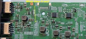

@eddiewang76529 excellent troubleshooting. The clicking commonly happens with a bad mainboard. Yours is more complicated since you get the signals except video. The problem is that your T-con circuit is on the mainboard. If you can, try to rake some good images of the mainboard. It’ll have to be focused and large enough yo zoom in to the components and the reference designators ( if this board has them). We’d be looking for Vdd, Vss and other test-points. Also, there should be a 12v line going to the panel. If the test-points are there and if the voltages are right, then a Tape-off can help. Remember that even a tape-off only works about 75% of the time.
Add a picture of the connectors where the two ribbon cables terminate too. Lets see what that looks like.
Update (10/09/23)
@eddiewang76529 check the few components I marked with some blue arrows. Check for continuity and voltage (VDC). You'll have to test those with your TV "on" so be mindful of the power board etc. Use your probes to touch things on the board, not your fingers :-) At that point it could be a shocking experience. So, use caution and consider your power board will bite.

@eddiewang76529 looks like there are test-points on the bottom right quadrant of your first picture. Possible to get a more focused image of that area?

Thank you very much for the input. I tried to look for Vdd, Vss and 12V on the main board but I have no luck pinpointing them, can you tell me which area I should be looking at? Below are two photos of the main board, one shows top half and the other bottom.

@eddiewang76529 We got that taken care off, now let me see if I can find the test-points we need to determine what's broke (or at least come close ;-)
@eddiewang76529 Picture number 7 bottom L corner looks like a ribbon cable. Does your panel have more than 2 driver boards? Are those connected via ribbon cables as well? If so, repeat your test but this time disconnect each one of those. power off, disconnect ribbon cable, power on retry. Power off, reconnect, disconnect other side, power on, retry.
Still checking the main board for any hint of the right test points. Darn, getting old. that writing is freaking small :-) "I'm so mad I'm getting old It makes me reckless"
