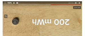

I ordered a pair of Varta CP1254 A3 batteries advertised for Powerbeats on eBay but the 5.4mm height is about 1mm taller than the OEM battery. It doesn't fit. All the listing specs also have 5.4mm height? Any suggestions?

Have you checked the original battery to see what model number is stamped on it?
@jayeff
No markings on the OEM battery at all I'm afraid

Hi @harveyhimel
Here's the ifixit Powerbeats Pro Teardown video that shows how to access the battery.
The battery make and model number is Varta CP1254 A3. Search online for Varta CP1254 A3 to find suppliers that suit you best.
Here's an image from the video that may help
(click to enlarge)
