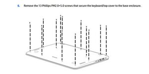

@ajzimmermann here is the service manual HP Chromebook 14 G4 SM that should work for your computer. Each component listed for removal has the proper screw thread diameter and length listed. i.e. the bottom case has 13 M2.0 x 5 mm in length
Yes, it's a bit of work but at least you can determine exactly which screws you will need.
