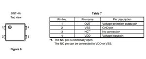

I have a g14 zephyrus 2021 laptop that doesn't power on, I found a 30 ohm smd resistor that is reading a very high resistance under the logic board near the DC in jack and a 4.7 ohm smd resistor that is burned near the battery charging IC, I tried replacing both resistors though the 30 ohm goes bad after putting power to the logic board, the second mosfet near the DC in jack is reading 4.3 volts and the mosfet before it, there is no voltage in the gate. The 30 ohm resistor, there is 20 volts going in and the other side is about 2 volts, I remove the resistor and put 1volt into the other end, which draws 300mA, there a smd component between the two mosfets near the power in jack that has 4 pins and gets hot, I found a short on this component. I attached a picture of it, one part reads like a diode. Do anyone know what this is?

I removed the component and tested it again. It is pin 2 and 4 that are giving me a resistance of 2.6 ohms.

@andyversluys the data sheet has all the information about this component that you can measure. If you think it is the component that is short Get a replacement from Digikey or Mouser and many other place. and see if that fixes it.
@andyversluys not necessarily shorted. The PLK marking would make this a Seiko voltage detector. That would also explain what you referred to as a "one part reads like a diode"
Check the datasheet S1000 E 1920173

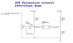

@andyversluys The component is reference designator PU9004
and it is a S-1000N25-I4T1U voltage detector. I only have the schematic for R1.4 but it should still have what you need Asus G14 GA401QM SchematicGA401QM REV1.4 BoardView
I do not know if Acrobat Reader will zoom in far enough for you to read the BV. I use a different viewer and have to go to 2000% zoom to see the smallest components.
Anyhow, best of luck with your repair.
Thank you for the boardview and info on the component, this will help me a lot on troubleshooting thus laptop.
