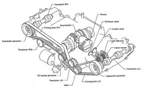

@alyssaflores your GL has a Boxer engine. Here is what the timing belt situation looks like
It does have a Left Hand and a Right Hand belt. I am not sure what you are referring too when you say the "balance shaft belt". Hopefully you can identify by the pictures what you are looking for.
That actually helps a lot thank you so much!
