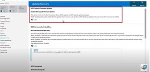

Tip:
We should turn off the "UEFI Capsule Firmware Updates" feature in BIOS so that windows does not download the Bios and update it itself.

You should turn off the "UEFI Capsule Firmware Updates" feature in BIOS so that windows does not download the Bios and update it itself.
I think you should limit all risks, it could happen again. And you don't have to spend money on this stupid error from Dell.
Thanks for the tip, I'll do that straight away! Glad your laptop is up and running again.
