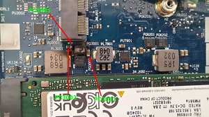

Component at PQ3001 burned out, cost estimate of repair?
I used a third party AC adapter, smoke came out of the charger port, then the laptop shut down.
Lenovo Legion 5 17ACH6H Type 82JY, 2020 not pro, Ryzen 7 5800H, RTX 3060, 16GB RAM
My laptop, position PQ3001, and possibly the capacitor next to it.
Here a user says it's 30V N-Channel MOSFET in a DFN 3x3 EP package
I live in Spain, would you please help me locate the components and how to repair it myself, or what to ask to ensure that a repair shop is capable of repairing it?
What is the likelihood of another component(s) also being damaged. I see no physical damage elsewhere.
The laptop will power on, the fans and keyboard light turn on, but the screen stays black and nothing further happens. No response, no beeps.

The capacitor seems unmarked. It's next to PL3001, but I assume that's not the capacitor.
The non-burnt out piece next to the burnt one says 7380 NLON2D on it. The burnt piece looks like it says R20, B20 or P20 on it, but it's hard to tell.

@timothyparadis Here are the components that I assumed you were talking about :-)
The statement about PQ3001 being a 30V N-Channel MOSFET in a DFN 3x3 EP package is still correct. The official part description for that is AONR32340C_DFN8-5
Now for the rest of your parts:
Reference designator PC3001 is a 0.1µF 25V 10% capacitor in a 0402 package
Reference designator PC3002 is a is a 10µF 25V 10% capacitor in a 0603 package
Reference designator PC3032 is a is a 10µF 25V 10% capacitor in a 0603 package
Let me know if I missed anything. Some things are getting hard to see with my old eyes.
Those parts are all relative easy to obtain. I am not sure what supplier of passive components you have in your area. I do know that Digikey.com and Mouser.Com (both are pretty costly) have a presence in Spain as well.

I cannot find AONR32340C for sale.
What I can find is this. The relevant information appears to be the same. With a non-booting laptop, what are the chances I make thing worse by installing this MOSFET?
785-AONR32320CCT-ND
N-Channel 30 V 9.5A (Ta), 12A (Tc) 3.1W (Ta), 11W (Tc) Surface Mount 8-DFN-EP (3x3)
I can't tell if PC3002 is damaged or is just marked from the MOSFET burning. Do I run the risk of damaging anything if I replace the MOSFET and attempt to boot before replacing the capacitor?
@timothyparadis not finding the PQ3001 was the issue on the other question as well. looks like the 32320 has less amperage. 32340 is a 12A transistor. Here is the datasheet. If you can, see if you can match it up. If not I'll try Mouser and/or Digikey.
AOS AONR32340C
Those capacitors are really inexpensive, if in doubt, replace it :-)
@timothyparadis from the electrical specs a Vishay SiS412DN would work. The issue we are running into is the package size. Can you measure the MOSFET PQ3002 (width and length)?
I cannot see that PDF. I think this is also the datasheet. I'm not sure what I'm matching. The fried and disintegrated MOSFET on my laptop, or the listing on digikey/mouser? The 32320 MOSFET I found was digikey.
https://alltransistors.com/es/adv/pdfvie...
@oldturkey03 PQ3002 as best I can tell without callipers is 3x3mm
