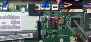

Hey @sherwinundug , i had the same issue twice!
The keyboard is a entire piece with the superior frame, so for fix, you need a replace this piece.
The piece Number in my case the Aspire 3 A315/A515 is AP28Z000300-HA25.
Or you can Jump the board and add a Switch for boot up.
Pins 1 and 2
