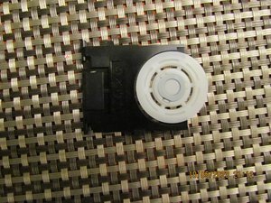

Once I got my Optical Drive Laser I took it apart and removed the optical disc laser from the replacement disc drive. That wasn't the only part I removed however, as I also removed this part from my original drive and swapped it for the one from the replacement drive:
I did this because I noticed while it was in my original disc drive the white piece moved freely with lots of wiggle room. When I removed it from my original disc drive the white piece also popped right off from the black piece which isn't something that the new piece did at all.
When I put the new piece in my original disc drive it did not move around as much and held the disc in place while allowing it to spin, which I believe it should do, if anyone can confirm that feel free to do so. The original did not do this, so I believe whatever piece that is went bad.

I also caution anyone that while disassembling your disc drive to replace the optical disc laser and whatever that black plastic part is, to be careful that you don't pull the red and black cables out from the pcb board and the drive itself because then you will need to solder them back on or find someone to do it for you.
That's it for me, I seem to have fixed my Xbox One's disc drive all thanks to myself and if you have a similar problem try trouble shooting what I did. Especially check that black plastic piece to see if it is loose and wiggles freely.
