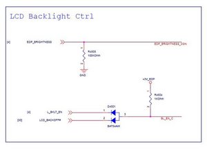

I have recently received this ASUS laptop to repair. This ASUS laptop does display, but no backlight is on. Tested it on an external display, and it display just fine. I have tried other display with the same connector and got the same no backlight (the backlight does work on these other displays). I also tried the display with another laptop with the same 30-pin connector, there is still no backlight on the original display. I even tried replacing the display cable to see if anything might display on the other displays since the original might have a dead backlight, that didn’t fix it. So I am not sure what else to do besides replace the original display. Is there anything else I should try first?
@techb31 this "there is still no backlight on the original display." would mean that you have a bad backlight in the panel. Of course, you made sure that the display and the computer that you tested it on, are compatible. It is not enough to assume that just because they have the same connector, that the wiring is identical. Have you checked to see if your can see your desktop etc. if you shine a flashlight beam at an angle against your display? Try that in a darkened room and see what you get.
I suggest that you post some good pictures of your motherboard with your Question. then a separate one of the display connector. Let's see what it looks like. It is possible that this is a connector issue, a backlight power issue (blown fuse etc.) or a bad backlight driver issue.
Hi @techb31
If the motherboard model number is Asus X510UA V3.0 (apparently this board is used for F510UA as well) then if the replacement LCD panels are compatible, here are some images showing the backlight power circuit and backlight enable/disable circuit for the model.
I'm not that familiar with the way this circuit is drawn out and I don't know what component designation SL means but looking at the way it is drawn I think that component SL4505 may be a fuse with a package size of 0805, but as to its rating I have no idea.
Anyway check if there's a voltage on the eDP connector pins 37→40.
If not try to locate the component SL4505 and check if there is a voltage on both sides of the component or with the laptop turned off, if it measures 0.00 Ohms i.e. a short circuit, which it should
Normally there is voltage supplied all the time to the backlights and it is turned on and off in the panel by a voltage signal (3V-5V) on the backlight enable lead (pin 34 of eDP connector) so maybe check if the diodes (D4501) are OK or not.

Note: ignore the circles shown on the schematic in the 1st image. They were already there and not done by me. I added the arrows and the rectangles ;-)
