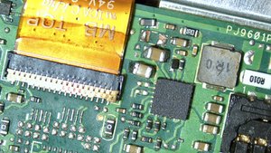

At this point I decided to have a look inside - someone definitely been here before me - half of the screws are missing and I found that all of the caps I marked with red are all shorted to ground:
At the same time the caps I marked with blue are not shorted.
It could be a result of a liquid damage, because I found way too many traces of that on the keyboard, but could not really find anything obvious on the main board.

So for the sake of convenience here are the images of the board on both sides:
And once again - I found that caps in the red area are shorted to ground and the ones in the blue are not:
And today I also found that these caps I marked with red circles are shorted (continuous with zero ohm resistance), so I believe the problem could possibly be one of them.
Wrong - after reassembly I, for one, found that whoever assembled this before forgot to connect an antenna and just hidden antenna wire under the main board, and second - those caps now do show some viable resistance, so I guess they are fine and maybe problem is with some chip.

I kept investigating and found out that it's not the battery that gets hot - it's one of the chips on the bottom of the motherboard - the one marked with red
If we look closer - we'll see that there are two similar RAM chips and they are Hynix H9CCNNN8KTML BRNTM 338A.
Correct me if I'am wrong, but I don't think it's economically viable replacing those since I can't do that myself and will have to pay for the chips and the job to be done.

And of course I immediately examined this board and right away was able to see someone's previous... hmm... repair attempt fail🤦‍♂️
Waiting for a hot air station to arrive and then maybe I'll be able to fix this🤞
@insympathy this "After a while battery gets insanely hot" would actually be more related to the battery then the charger. Your battery control board should cut of the charge before your battery gets to that point. I'd replace the battery first.
We would need to know what make and model your motherboard is. That way we could try to figure out what happend. It had to be major in order for all of those caps to be falsely connecting to ground.

I disconnected the battery and that didn’t change anything, so the problem is somewhere else I believe. Btw after disconnecting the battery the device kept draining around 1,5-1,6 amps.
As for the motherboard- it’s a “T100TA Main Board Rev 2.0”
