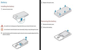

If the battery still drains fast when using the phone in safe mode, then perhaps the battery is failing and needs to be replaced. Even rechargeable batteries have a lifespan.
Here's an image that shows how to remove/replace the battery in the phone.
Search online for Galaxy J4 battery to find battery suppliers that suit you best.
(click on image)
