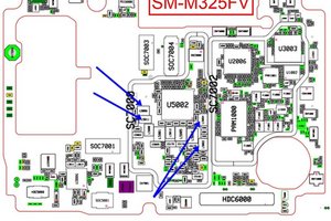

Actually, the phone that I have [M325G] not mention in the Samsung phone category. the problem of my phone is whenever I switch on the phone its running some time and then switch off and heat generate and never switch on till the battery drain and cool down. and there after I charge it and its switch on and running smoothly sometimes, and the process is continued what can I do
