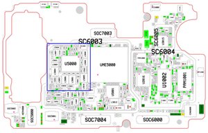

Once you've checked all that and still no resolution, you will need to get a step further. This time you need to check the power components on the board.
The location of the components is within the Blue rectangle.
