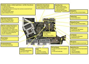

Hi everybody!
I have a 2011 21.5” iMac which I won't turn on. A friend of mine did a check and it was not the powersupply or the power on button. He says the board does not get power. I have no experience of electronics, but maybe it is just better to buy a new board and try to see if i can save the iMac. The screen is old but very nice.

Not to denigrate your friend but I'll bet it's the power supply. The #1 diagnostic LED will be on even if it just getting a power trickle so a failed one may still show the LED lit. PSUs go out often but not logic boards. Also the PSU is much cheaper than a logic board. To increase speed, replace the rotational hard drive with an SSD. Also the RAM is easily upgraded, there is a door just above the power cord. Your machine has 4 RAM slots and only 2 are populated from the factory (a cheap (about $30.00 or less) upgrade to double the RAM. Install an additional two 4MB chips.

@uzapucax like it was already mentioned, LED 1 only means that you have a AC power source and that your PSU receives power. It doesn't mean that your PSU is working. Case like yours you have to
• Verify power button cable connection to logic board.
• Verify power button functionality.
• Verify cable connection between power supply and logic board.
• Verify power supply.
• Verify logic board
Just replacing boards without testing can get pretty expensive and we are all pretty frugal here.

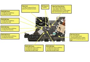

By the way, would you know where to get a online a good electrical schematic circuits diagram for an iMac 2011?
@uzapucax the only things that are available and that Apple does not want to have us to have, are the board schematics and the technician guide.
Here's a site that I've used before and is pretty reputable.
